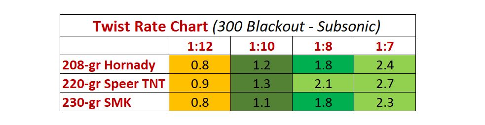

300 Blackout Subsonic
Subsonic 300 BLK is much more forgiving: You can get away with using a 1:10 to 1:7 twist, with 1:8 in the middle being ideal for most loads. Data was not available for 240-grain subsonics, but those heavy rounds benefit most from a 1:7 twist rate.

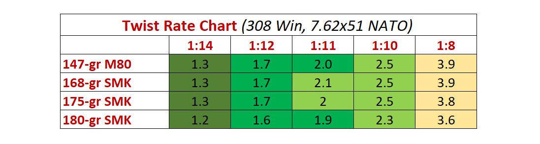

.308 Winchester, 7.62×51 NATO
Good ole’ .308 Winchester and its NATO sister are consistent performers. Stability remains high across most grain counts and rates, with 1:12 to 1:10 twists being established as the community favorites.

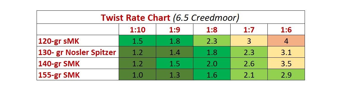

6.5 Creedmoor
Like .308 Win, the 6.5 Creedmoor round is pretty forgiving when it comes to spin. A 1:8 rate is ideal for being able to stabilize most of the 6.5mm’s common loads. If you’re hunting for a pair of antlers, 1:8 also works best for those heavy 155-grain soft points and deer cartridges. Anything between 1:10 and 1:7 will consistently stabilize all but the lightest 120-grain plinkers.
