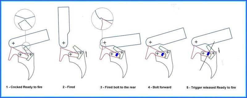

Just stumbled across this diagram over at RFC, and thought it might help with diagnosis...
Sounds like your sear isn't catching the hammer on its return trip.
From what I can figure, one of two things is causing this. Either (1) your hammer/sear engagement is FUBAR, or (2) your disconnector isn't resetting the sear.
Have you checked your disconnector/sear spring?
EDIT: Can you "hold off" the second shot? By that I mean pull the trigger (bang), then hold it back (no bang), until you release (bang). Or was it doubling/following?
